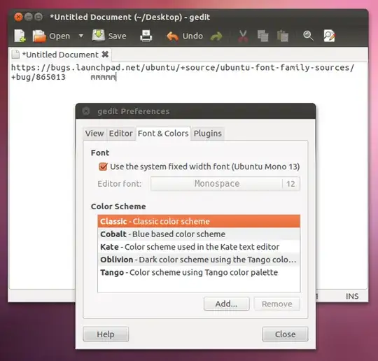

To install gnome-tweak-tool in Ubuntu 12.04-20.04 open the terminal and type
sudo apt-get install gnome-tweak-tool
In fonts you can change the systemwide font.
For gedit:
(source: iloveubuntu.net)

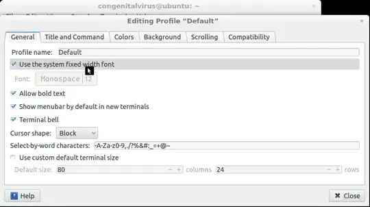

Not sure about the editor but for the terminal just change the font for the default profile from the
Edit -> Profile menu
Cheers

For the terminal, you can right-click in the content window (not the title bar), and choose 'Profiles', then 'Profile preferences'. You then get the same dialog as showed in 0x00F's answer
