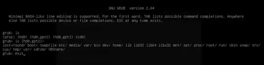

You can do this from the grub menu while booting, just press c for a command mode prompt and then ls to list the partitions. You should see a list containing things like (hd0,msdos1) or (hd0,gpt1). These are partitions on your system and you are looking for the one containing your home directory. To do this type ls (hdX,Y)/ at the command mode prompt to list the contents of the top level of that partition. If you don't have a separate home partition you are looking for the partition containing home/ as below. If you do have a separate home partition you are looking for john/ or jane/ or what ever your username is.
