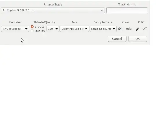

I'm attempting to transcode a video file using Handbrake on Ubuntu 18.04, and I'd like the output to use the Opus codec. This appears to be supported generally by Handbrake, but it is disabled for me:
Opus disabled

It turns out that I simply needed to manually change container formats to allow Opus to be used. On the summary tab, I simply changed from MPEG-4 to Matroska.
