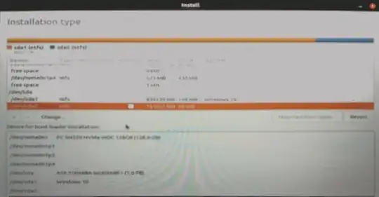

I'm currently using UEFI for my Windows 10. I am confused as to which bootloader device I should use. Here is my installation partitioning screen.

To answer you question, selecting the entire ssd will work, but having the bootloader in a separate drive can cause issues.
So as a safer alternative what you can do is make a new EFI partition and install the bootloader in it.

  • Use as: EFI (this will be listed as /dev/sda2 efi in the partitioning tool once you create it if you freed up space like in your photo)

Boot loader Device
  • BEFORE clicking "Install Now", from the "device for boot loader installation" option button, select the 250MB - 500MB EFI partition you just created as the target for the bootloader. (probably **/dev/sda2).

Your new picture showing the options to use is when you boot with a MBR install loading for the install. It will not give the option for an EFI system partition that is only displayed when you have booted in EFI mode as I have already mentioned. You either need to go into the firmware on your machine and disabled the bios compatibility (CSM) mode. This will force the EFI boot for the installer, they are universal these days with both methods on them. The method used depending on the booting of the installer. So either the disable or the F12 in my case to be able to choose. Now there is no law saying you have to use the EFI, you can proceed with a MBR install as it look like you computer will do it. But it will be matter of always using the the F12 boot menu key to be able to choose the drive you want to boot from if it is not the default. As the Linux install of Grub will never be able too boot the EFI windows as it is not made to boot EFI when installed as MBR. And now I see the second picture the 1TB drive is partitioned for MBR use it will never be able to do an EFI install there is no EFI system partition like your 128gb drive has as its first partition a proper Microsoft partition as they only do the 100mb for it. You need to use disk management and re-partition the 1TB drive as GPT partitioned to be able to install as EFI for the Linux. It will never work for EFI without the special type EFI system partition as the first partition on the drive, due to the EFI boot specification requirements.
Edit: If you do the re-partition all data on the drive will be lost, backup anything important.
