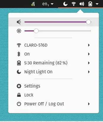

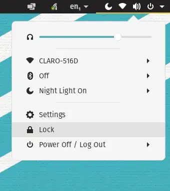

I know that the setting had-bluetooth-devices-setup, in the dconf editor, when set to True shows the Bluetooth indicator even when it's turned off, which is what I would like. But, almost every time I turn the Bluetooth off, that setting gets turned off automatically, making the Bluetooth indicator disappear.
I'm experiencing this issue on a laptop with Ubuntu installed on it. However, I also have a personal computer with Pop_OS! installed. In the computer with Pop_OS! installed, when the bluetooth is turned off, the indicator doesn't disappear from the top panel menu, without fail; it remains in the menu in the top panel when clicking there, and I don't have to go to the settings to turn the bluetooth on. The opposite happens in the Ubuntu laptop; upon turning the bluetooth off from the top panel menu, the bluetooth indicator just disappears, and I'm forced to go into settings if I wish to turn the bluetooth back on. If there was a way to port the bluetooth behaviour from Pop_OS! to Ubuntu then that would be great.
For reference, here is how it looks like on the Ubuntu laptop when bluetooth is turned on:
Bluetooth indicator is present when bluetooth is turned on

This is how it looks like when the bluetooth is turned off on the desktop computer with Pop_OS! installed:
Bluetooth indicator does not disappear when turned off on Pop_os!
