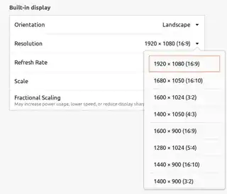

but they do not show in Settings -> Displays -> Resolution
Moreover, there are many other available modes, which were not added by me, which do not show in Settings either. I could select my custom modes via command line with, e.g.,
$ xrandr --output eDP-1-1 --mode "1344x744_60.00"
but I want to have them available also via menu.
How can I have at least my custom modes shown in Settings?
What determines which modes are shown in Settings?
