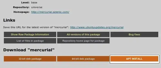

I had the same problem.
Installing Mercurial from ubuntuupdates.org
and then installing tortoiseHg using sudo apt-get install tortoisehg solved my problem.

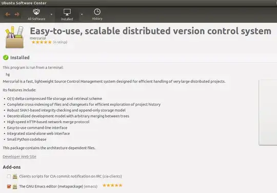

Why are you installing TortoiseHg and Mercurial from PPAs if both are easily available from the Software Center?
If a given software requires an specific version to run, and this is not clearly described in the .deb package (which would prevent you from installing it when versions mismatch), I would seriously question the quality of those builds.
To avoid this kind of headaches is precisely what Software Center was made for.
That said, to install to a specific version of any package, do this:
apt-cache policy mercurial
Check Version table options. Choose one that fits Tortoise's requirement. then:
apt-get install mercurial=<version>

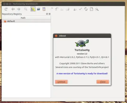

-1
Installing TortoiseHg using sudo apt-get install tortoisehg solved my problem.
