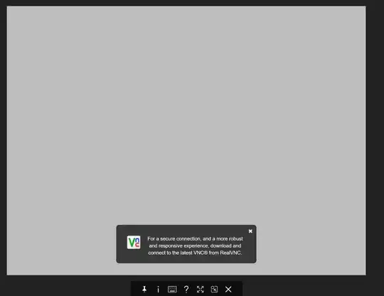

Here is what I get when I try to view the desktop: VNC Connection
