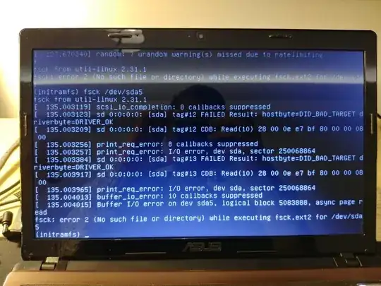

Tried to update 18.04 system via "Software Update Tool" but it crashed halfway with message "Your Software Update Tool have been corrupted please reinstall for further use" or smth like that. After that the system crashed and I can only access my grub menu. Entering Recovery mode kicks me into initramfs screen (normal boot shows only blackscreen, no splash or code info)
Initramfs ask for fsck on dev/sda5 (where Xubuntu system resides) but when doing so it simply return error with "no such directory"
From Live CD session I figured out that there is no way I can access my SSD disk (sda) data, where are my system files resides (WINDOWS sda1 and Xubuntu sda5 - dual boot). I could only acces my HDD (sdb) with "home" directory and swap partition.

EDIT 1: Code log below from booting into recovery mode and crashing to initramfs
ata1.000: failed command: WRITE FPDMA QUEUED
ata1.000: cmd 61/08:a8:08:44:3b/00:00:0d:00:00/40 tag 19 ncq dma 4096 out
res 40/00:00:00:00:00/00:00:00:00:00/00 Emask 0x4 (timeout)
ata1.000: status { DRDY }
ata1.000: hard resetting link
ata1.000: link is slow to respond, please be patient (ready=0)
ata1.000: COMRESET failed (errno=-16)
....repeating several times above error and then:
fsck.ext4: Input/output error while trying to re-open /dev/sda5
/dev/sda5: ******* WARNING: Filesystem still has errors ********
fsck exited with status code 12
done
Failure: File system check of the root filesystem failed
The root filesystem ob /dev/sda5 requires a manual fsck
BusyBox v1.27.2 (Ubuntu 1:1.27.2-2ubuntu3.2) built in-shell (ash)
(initramfs)_
Can not perform manual fsck on /dev/sda5 cuz of INPUT/OUTPUT error on SSD
