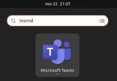

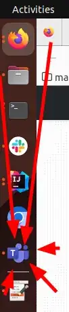

  • Installing from Chrome, where Chrome is installed as an apt package (google-chrome-stable). This works :). After clicking install from Chrome, Ubuntu initially treats it as a second Chrome window. However, I closed the window, checked the app drawer, and there it was, with the Teams icon and everything. I started the application and this time, Ubuntu correctly considered it a separate application that I could pin to my Dash.

The app Drawer:
app drawer
The Dash (left) and PWA (right):
dash PWA

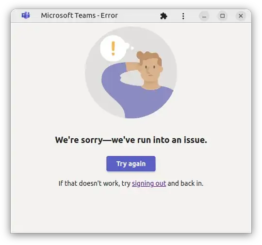

The error in the screenshot is due to the uMatrix browser extension (yes, your browser extensions run in the the PWA as well) blocking some things.
