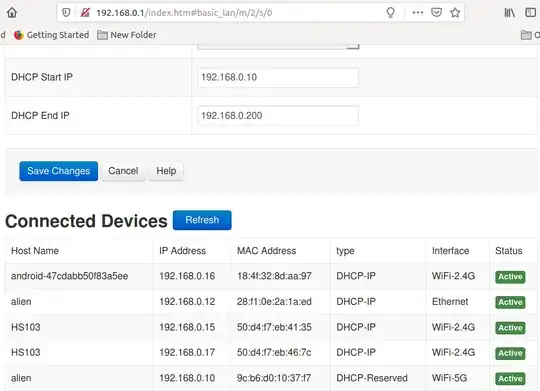

I've rebooted laptop numerous times, run sudo apt update && sudo apt upgrade, rebooted router and looked at the router configuration:
The setting "DHCP-Reserved" for the WiFi card stands out. All my IP addresses are static:

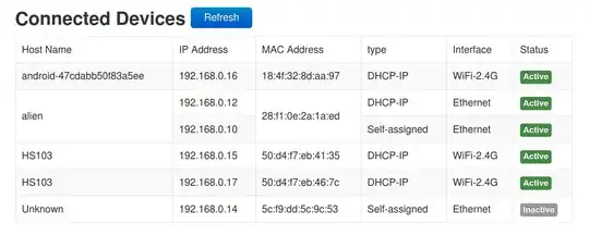

Edit February 2, 2021
The issue is that DNS lookup doesn't function when both Ethernet and WiFi connected. Internet is available through direct IP addressing. Looking at the router when both Wifi and Ethernet are connected values appear to be changing?
So now I'll go down the DNS rabbit hole...
