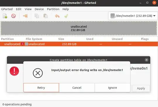

Gparted screenshot I/O error
So I tried, once again, to do a fresh installation, seeing as this time I probably wouldn't lose that much. But kept getting an I/O Error while trying to write on nvme0n1, so I did a live boot through the USB drive and opened gparted, and again, the same error, I couldn't format the drive, nor delete its partitions. I could format the SATA drive normally and create/remove partitions.

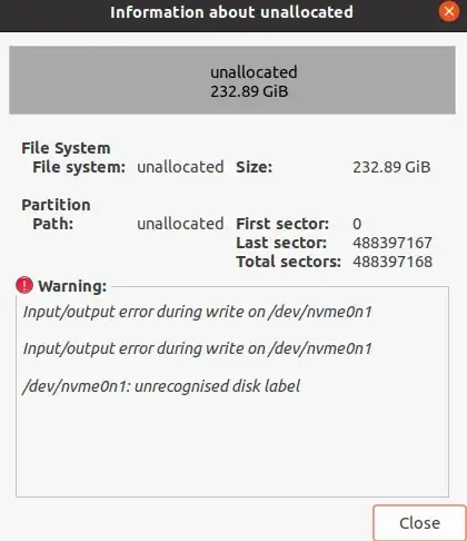

Opening properties of the drive shows that it has an unrecognized disk label:
Screenshot of info about unallocated

Are you sure that the drive is seated precisely as it should on the motherboard? I have had strange things like this happen when memory chips, disk drive cables and power were not snug everywhere, but I am not sure about nvme are hooked up. Check the manual with your nvme drive to make sure you haven't missed anything.
Either that, or possibly the drive is defective. Contact your vendor if it's under warranty still and ask for a replacement.
