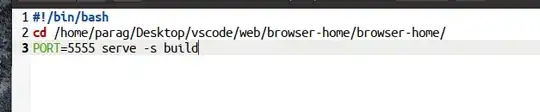

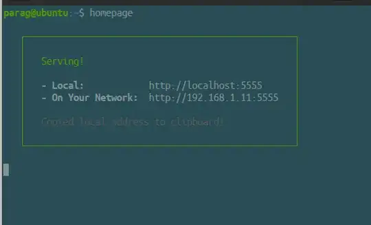

I created a script to run my react build on port 5555
and on running it, I get
I want to quit this process without killing the server.
How can I do it?

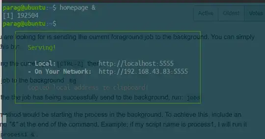

Output with &

Another method would be starting the process in the background. To achieve this, include an ampersand "&" at the end of the command. Example;
if my script name is process1, I will run it using ./process1 &.
