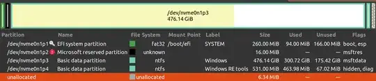

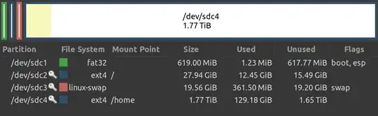

edit: Here is what my drives look like in gparted:
Ubunutu drive: Ubunutu drive Windows drive: Windows drive Windows storage drive: Windows storage drive

You seem to have selected the Windows EFI partition as the bootloader location for grub during install.
  1. Boot into Ubuntu and run sudo grub-install /dev/sdc
  2. Make a backup of fstab (sudo cp /etc/fstab /etc/fstab.bak
  3. Find and copy the UUID of the Ubuntu EFI partition using sudo blkid
  4. Run sudo nano /etc/fstab and replace the UUID of the partition with the mountpoint /boot/efi with the UUID you copied.
  5. Run sudo umount /boot/efi
  6. Run sudo mount /dev/sdc1 /boot/efi
  7. Run sudo update-grub
  8. Reboot.
