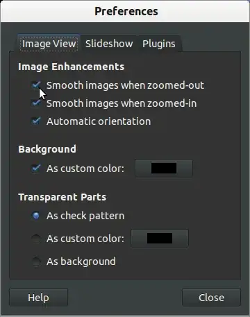

Open gThumb and go to Edit > Preferences and make sure that Smooth images is checked.
Image View tab in Preferences dialog
