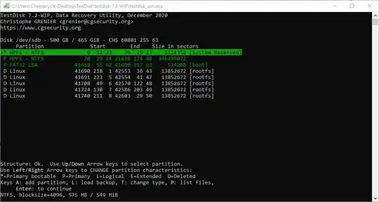

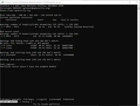

TestDisk Analyse shows: https://i.sstatic.net/UckRi.jpg

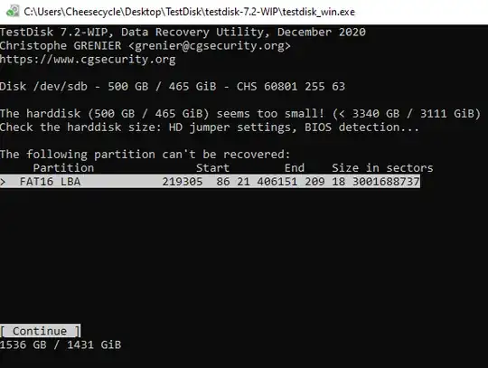

TestDisk Quick Search results in a partition that cannot be recovered and an error that the hard disk seems too small (remnants of adjusting partition sizes in the past?):
Continuing to the next screen:

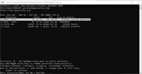

Quick search results:
I can view files in the FAT32 LBA and Linux partitions, though the Linux partition is obviously missing a lot of files.
The next screen displays "No partition found or selected for recovery." After the deeper search I see the same "hard disk seems too small", "following partition can't be recovered", and warning about the number of heads per cylinder as the quick search (screenshots above), then:
The first Linux partition is the same as one shown in the quick search, the others all say "No file found, filesystem may be damaged."

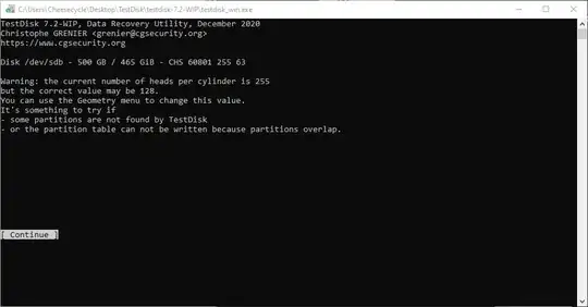

If I go to geometry and change the number of heads to 128 as suggested, I see the following in Analyze.
And then get the same results as before with the quick search and deep search, except for warnings regarding a mismatch in number of heads/cylinder.
