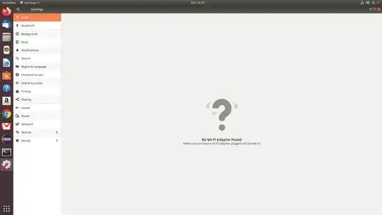

Not sure how to install a WiFi driver in Ubuntu 18.04 as I have tried many way to solve the issue. Now I can't connect to internet through WiFi. I couldn't find a solution for Thinkpad E14 gen 2
SOLVED: must update kernel to 5.11 You can do this by installing Ubuntu Mainline Kernel installer. There are tutorials on line on how to install Mainline. The lenovo thinkpad P14s uses the AX201 wifi 6 and is therefore not supported in lower kernel. Do remember that newer kernels may not be stable and could lead to other issues until it is certified as stable.
