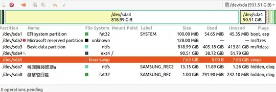

New edit: strange things about swap...
free -h shows...
              total        used        free      shared  buff/cache   available
Mem:          7,7Gi       3,6Gi       933Mi        88Mi       3,2Gi       3,7Gi
Swap:         1,3Gi       121Mi       1,2Gi
But gparted and disk usage shows...:
That's what I had set on install...
