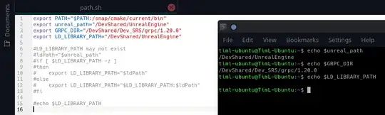

I want to set an environment variable LD_LIBRARY_PATH which may or may not exist (it does not seem to exist currently, but I'm not sure if it will at some point). I have successfully managed to set my own vars, and extend the PATH variable as well, by placing my path.sh into /etc/profile.d/ and that works fine, however this new variable just does not seem to work. I have tried extending it or seting it new, with and without if / else (see screenshot). No matter what I do, it simply won't be added to the environment variables and I have no idea why (since it worked before). I did reboot, so that should not be the issue
ScriptAndOutput

Note that if I call the script via sudo bash /etc/profile.d/path.sh with the latter part executing rather than commented out, the bash actually does echo the correct path. Also, that ldPath variable was just for testing purposes, it is not actually necessary.
