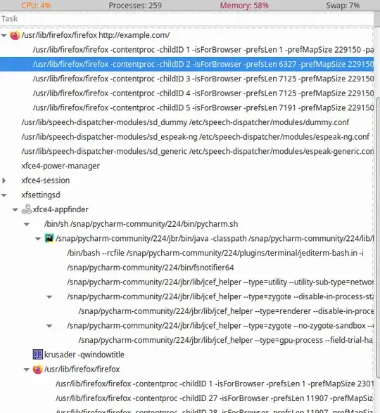

I've got a new installation of Xubuntu (20.04 LTS). I'm using Firefox web browser, but it acts strange - when I open a http(s) link from some applications, it opens normally, but for others, the link opens in a new window. This window has different settings (search engines, shortcuts, ...) and none of the plugins are there.
Looking at the task manager, enter image description here
I see there are separate processes for FF that's working fine and the one without plugins/settings, ... But both processes use the same binary /usr/lib/firefox/firefox
The applications from where the links take me to the "broken" FF seam to be installed by Snap (Slack, PyCharm, ...), but there are some applications installed by Snap that work fine (Kate)
Both xdg-open http(s)://example.com and exo-open http(s)://example.com open the link in the correct instance of FF.
How do I get rid of the double instance/settings/plugins FF?

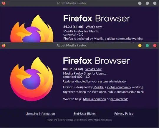

As said, you may have 2 Firefox installations from 2 different sources, one is the apt package and the other is the snap package or you may have 2 firefox profiles running at the same time.
Solution 1: Check your Firefox installation source
Determine wich version of firefox you're running
In each firefox instance go to ☰ Menu > Help > About Firefox
  • Firefox installed from apt is:
Mozilla Firefox for Ubuntu
canonical - 1.0
  • Firefox installed from snap is:
Mozilla Firefox for Snap for Ubuntu
canonical-002 - 1.0
Different Firefox instances running at the same time installed from different sources
