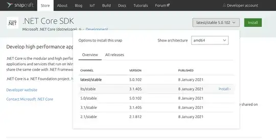

Looks like Microsoft has not yet added 3.1.405 to their repository, which means you'll need to do a manual installation. Alternatively, it does appear to be available as a Snap if you choose to go that route.
.Net as a Snap
