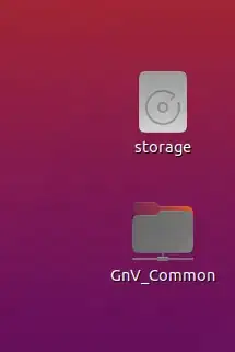

I also have a Synology NAS connected to the same switch mounted in fstab which works perfectly fine. The NAS share (GnV_Common) is shown on the desktop using GNOME Extension Desktop Icons NG (DING).

I mention the NAS arrangement because, curiously, when the internet drops out, the NAS share disappears from the desktop too (Network Manager related perhaps).

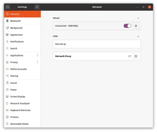

On a few occasions, I have noticed that there is no internet access on the 20.04.1 box but yet the Network Manager indicates that it is connected (image from last incident), and the Network Manager icon on the System Tray remains constant:
