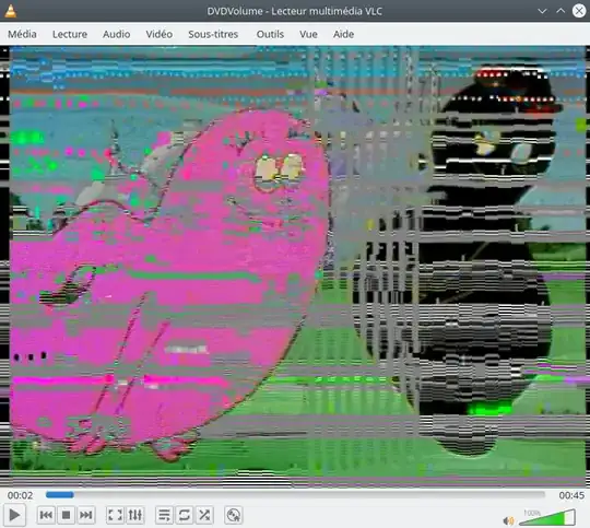

Symptom: when reading any DVD, with any reader, the image appears scrambled:
Image appearing scrambled in VLC
So here is what I saw:
  • I have the same result with almost all players: VLC, Xine, Kaffeine,
  • A notable exception is Dragon player, which displays the image properly but freezes after around 30 seconds.
EDIT: With Totem player, the image is not scrambled but the videos hangs a little: it slows down for a fraction of second, then speeds up. So, better, but not ideal.

SOLUTION:
As suggested by @raj, it was a hardware failure. Changing the vidéo card solved the problem. Thanks for your help!
SOLUTION:
As suggested by raj, it was a hardware failure. Changing the vidéo card solved the problem. Thanks for your help!
