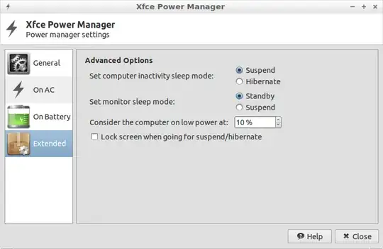

I think you have to disable the "lock" in two different places. First, open the power manager. You can click on the power icon in the panel and select "preferences" or it should also be in Menu -> Preferences -> Power Manager
http://dl.dropbox.com/u/35272968/site/2012-06-15-192224_740x482_scrot.png
De-select "Lock screen...." under the "Extended" menu tab.
