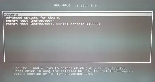

When I hold Shift during startup, I can see the grub startup menu:
I can choose "advanced options" and then the recovery mode and it starts with a low-resolution and without internet.

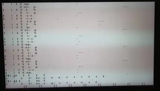

nomodeset
When I replace "quiet splash" by "nomodeset" in the boot options, I get the following instead of a black screen:
I can also switch with Ctrl+Alt+F1-F7 and I see that something changes, but I cannot read anything.
