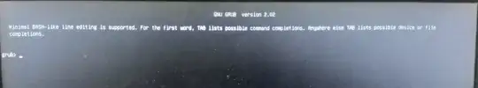

I had dual booted Ubuntu alongside Windows 10. I then deleted the Ubuntu partition using the Windows disk management system. But GRUB hasn't been deleted and it shows the dialogue below every time I start my PC.
Minimal BASH-like line editing is supported. For the first word, TAB lists possible command completions. Anywhere else TAB lists possible device or file completions.
grub>
grub dialog
To restore the default Windows 10 bootloader, do this:
  1. Log into Win 10
  2. Open "Command Prompt" as Administrator
  3. Type bootsect /nt60 <drive name>: /mbr
Note that <drive name> is the drive letter where the Master Boot Record (MBR) will be updated. For example to update the master boot record on C:, this is the command:
bootsect /nt60 c: /mbr
For more information about bootsect command, Microsoft has you covered
