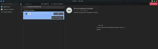

I recently attempted to install a required update which was needed by software I installed on PlayOnLinux, however the update never installed. The system would infinitely hang up on the install and I would be forced to kill the install process (not ideal I know).
Now the system continues to show the software (ttf-mscorefonts-installer) as an update in the Discover Center on Kubuntu. I am not having success removing the update via Discover or at the command line. Also notice - it shows the page is 0 B in size. I included a screenshot of the update in Discover.
