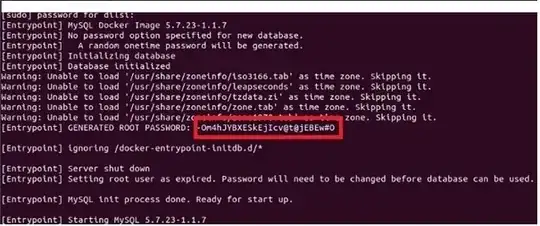

  1. Get the default root password for the MySQL server:
sudo docker logs mysqlCon
You'll see a line that looks like:
[Entrypoint] GENERATED ROOT PASSWORD {password}
Docker Log — MySQL Password
