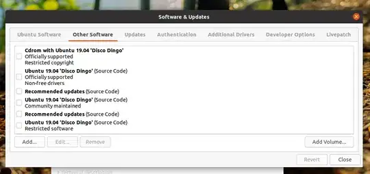

The simplest way to resolve this would be to remove "eoan" repositories from the updater.
  1. Open "Software & Updates"
  2. Uncheck unnecessary repositories
Software & Updates
From here apt will update itself and you should be good.
