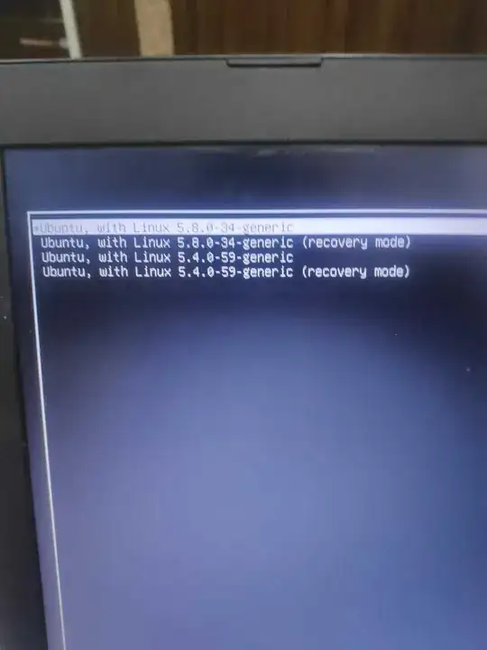

I have Ubuntu 20.04.1 LTS Desktop installed in my Lenovo Ideapad 320 Laptop and i had updated system few days back after restarting once finish the installed updates it booted ( kernel 5.8.0-34 generic) but with sluggish graphics and no network. So i tried few things but without network i couldn't do much so i restarted system and from grub advance options i choose older kernel ( 5.4.0-60 generic) and it worked without any issues. see image i have to choose 5.4 from this image to make ubuntu work without issues.ubuntu grub

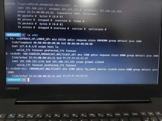

I then tried again apt-get update and apt-get upgrade commands but no luck it does install all the packages but if i boot with 5.8 kernel it just doesn't boot with network. see attached image for ip addr command (no network interfaces at all) when i boot with 5.8 kernel ip addr output
Can anyone tell me what could be issue here. how do i fix this mess? as whenever i restart i have to press escape and load grub and from advance option choose 5.4 kernel.
