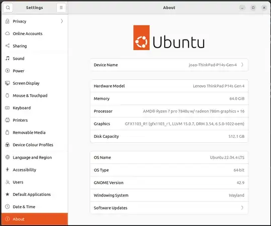

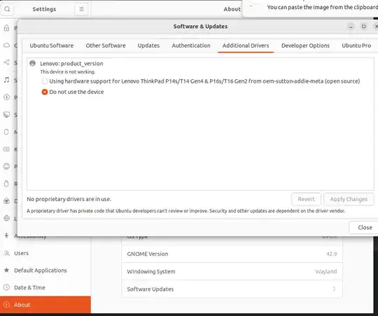

I was having same problem. I disabled Lenovo's additional drivers enter image description here
