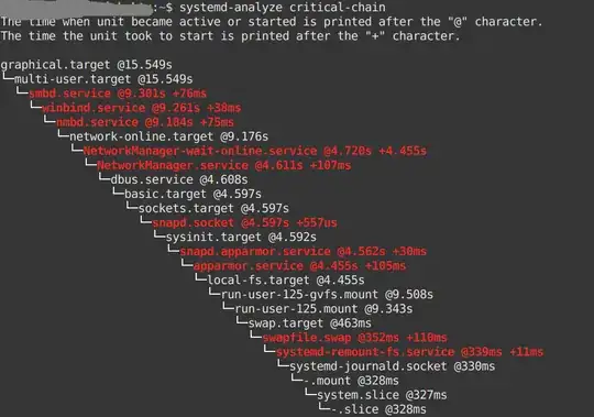

This systemd-analyze critical-chain, outputs
$ systemd-analyze blame, outputs:
