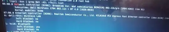

I was using my laptop, due to low battery issue it switched off and when I booted it again, The wifi option was missing from the top right tray and it doesn't even appear in the settings. I am attaching the picture describing the output of command lspci -knn | grep Net -A3; rfkill list Output:
06:00.0 Network controller [0280]: Broadcom Inc. and subsidiaries BCM43142 802.11b/g/n [14e4:4365] (rev 01)
    Subsystem: Dell Wireless 1704 802.11n + BT 4.0 [1028:0016]
    Kernel modules: bcma
07:00.0 Ethernet controller[0200]: Realtek Semiconductor Co., Ltd. RTL810xE PCI Express Fast Ethernet controller [10ec:8136] (rev 07)
0: dell-rbtn: Wireless LAN
    Soft blocked: no
    Hard blocked: no
1: hci0: Bluetooth
    Soft blocked: yes
    Hard blocked: no
