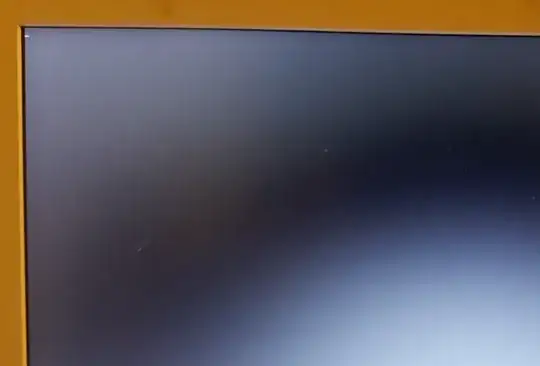

After installing an update proposed by Ubuntu 20.04 and having carried out the proposed reboot, I can no longer complete the boot, the system comes up to the moment of starting the graphical interface and then remains stationary showing only an underscore in the bottom corner top left. Sometimes after a while it seems to go on and everything goes black. In both cases, even waiting a lot, nothing happens anymore and I have to switch off by forcing. If I enter recovery mode I can enter command mode (but without network, I cannot start it).
