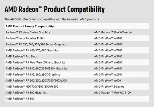

amdgpu-pro
AMD official info about the amdgpu-pro driver:
https://www.amd.com/en/support/kb/release-notes/rn-prorad-lin-amdgpupro
I see these in the table:
AMD Radeon™ R7 240/250/250X/260/260X/350
AMD Radeon™ R9 360 Graphics
But I don't see R7 360
amdgpu-pro driver compatibility chart
