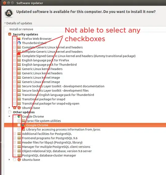

I am using ubuntu 16.04 and update-manager is asking for updating a couple of software frequently automatically (check attached screenshot).
Since a couple of weeks, I am not able to select any software to update (not able to click on checkboxes, it's disabled) (check the attached screenshot for better understanding)
Any help would be appriciated. enter image description here

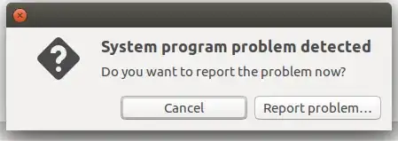

Please note, I am getting below popup while upgrade as well as when I start the computer first time enter image description here

Looks to me like the problem is a version-incompatible package, likely somewhere among the list of kept-back packages.
Package X requires dependency A.1, but the rest of the group of packages requires dependency A.2.
Since apt cannot install both A.1 and A.2, it cannot update any of the listed packages.
  1. The easiest way to fix the problem is to search your memory: Whatever the last thing you installed before the problem began is the likely culprit for Package X. Uninstall it. and see if that fixes the problem.
    • Use your apt history logs in /var/log/apt to see your install history and help you remember.
  2. The more tedious way is to run apt-cache policy <packagename> on each listed package, looking for the origin of the package. The culprit for Package X is the package(s) that is not from the official Ubuntu repositories, or is from a wrong-version repository.
    • Packages in the Ubuntu repositories are specifically tested to prevent this kind of problem.
  3. The aptitude application, provided by the aptitude package has a visual solver that can be very helpful to identify the problematic Package X, and to suggest alternative solutions. You may-or-may-not be able to install aptitude.
  4. Keep in mind that your release of Ubuntu (16.04) reaches the end of Community Support quite soon (April 2021), so expending a lot of effort may not be worthwhile. Another alternative is to begin migrating your data to a clean-installed Ubuntu 18.04 or 20.04 system.

I am posting my answer because it might be helpful for someone else. I found the very easy solution here https://askubuntu.com/a/602/286126 --> "Cautious solution 2:"
It worked very well
