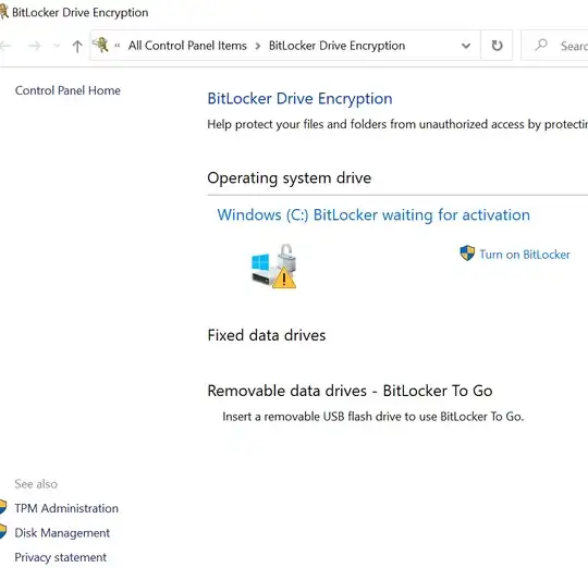

bitlocker encryption
bitlocker encryption is saying that it is not encrypted

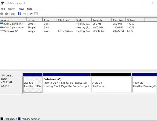

Disk managment is saying that it is encrypted this partition

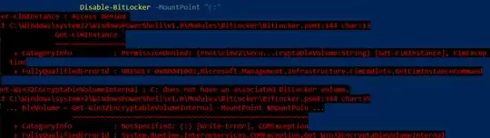

in powershell is saying that it is not encrypted . enter image description here
I have disable secure boot from bios too , does not work . So 2 are saying that it is and 2 are saying that it is not .

Did that : I faced the same scenario as I try to setup up the dual boot after having received a factory new dell laptop. Turned out for me that the "activation required" step simply is a UI stage as Windows wants me to savely store the recovery key on some media. After having done this and the "activation step" has been completed the device is shown to be encrypted without any processing. So the encryption was already in place, as the disk management and ubuntu both remark.
After activation the GUI shows the regular "device encrypted" screen and options so that the regular guides for decryption can be followed.

Did that and I have noticed that he is right and it is locked the drive C . But still did not work just with that .
https://docs.microsoft.com/en-us/powershell/module/bitlocker/disable-bitlocker?view=win10-ps
So I have done this in Powershell :
  1. Disable-BitLocker
  2. Remove-BitLockerKeyProtector
  3. Unlock-BitLocker
One of this commands worked but I do not know witch one ?! After that I have seen that in Disk Management the drive is without the word Bitlocker . Then back to Ubuntu installation and it worked perfect and I could install Ubuntu 20.04 in a dual boot with Win 10 64

I also had this problem. While I turned Bitlocker off on C: - the Recovery partition was also Bitlocker encrypted and I had to turn off the encryption for that partition too. For this you will need to assign a drive letter to the recovery partition and then it will show up in the Bitlocker menu (there I enabled and disabled the encryption). After that Ubuntu installed as expected.
