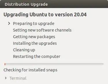

Recently, I successfully upgraded an old 4 GB laptop from 16.04 LTS to 18.04 LTS but soon after completing it I tried to make the jump to 20.04 LTS and a problem arose.
I was browsing on the 18.04 system when it started to restart. Last I remember it was near 70% of the way through the installation part.
