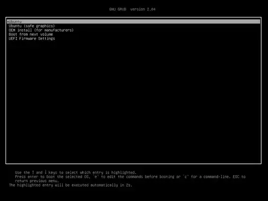

I tried to install Ubuntu 20.10 normally using USB stick but once I choose the first setup option *Ubuntu I cannot continue to the next step, so I choose the second choice Ubuntu (safe graphics).
After finishing the installation I cannot choose the first option from GRUB screen which is (Ubuntu) I used to choose the second one (Advanced options for Ubuntu) and the error below shown to me and I restarted the system many times so I can access Ubuntu with low graphics and low resolution.

I had that issue recently, and it seems to happen very frequently with AMD hardware
Here are the steps :
  • With the selector on your main GRUB entry type e to enter the editor
  • Find the entry that starts with linux
  • Delete quiet splash (or anything you have at the end of the line, but not touching any word that starts with a $) from the line (don't worry the change is only going to last one boot) replacing it with nomodeset (the line should look like this
linux   /boot/vmlinuz-5.9.12-050912-generic root=UUID=<REDACTED> ro nomodeset $vt_handoff
  • Boot using F10 and wait to be spawned to the DE (if you don't no worry, stike Ctrl-Alt-F2 to enter the tty)
  • Once logged and within an open terminal run :
sudo -i
nano /etc/initramfs-tools/initramfs.conf
Change the COMPRESS line from COMPRESS=lz4 to COMPRESS=gzip
Save the changes (Ctrl+x | y | Return)
then run update-initramfs -u
Reboot and done
