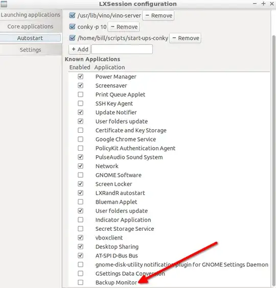

Lubuntu 18.04 by default starts the Backup Monitor task which can cause the Backup Now button to be grayed out.
To disable the Backup Monitor task,
  1. Start Lubuntu and log in
  2. From the menu, select Preferences / Default Applications for LXSession
  3. Click Autostart at the left
  4. In the box at the bottom labeled Known Applications locate the item labeled Backup Monitor and untick its box
  1. Restart the computer, then log back in
  2. Plug your freshly prepared external backup media, formatted to ext4 and with a proper data partition created, into your system. Ensure that it is writeable by your user; use pcmanfm to create a dummy text file on it, then delete the dummy text fil.
  3. Start Deja-Dup, aka Backups.
  4. Configure Folders To Save and Folders to Ignore to meet your needs
  5. Select Storage Location and point to your external backup media
  6. Click Backup Now. A full backup will start.
Report back with details if any issues are encountered.
