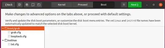

Based on the comments, I tried the following. Please note, I'm using cubic.
- Boot options directory looks like the following:

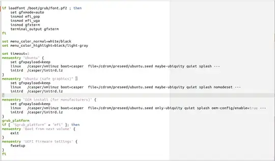

- Unedited boot/grub/grub.cfg looks like the following:

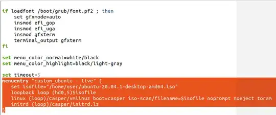

- My modification:

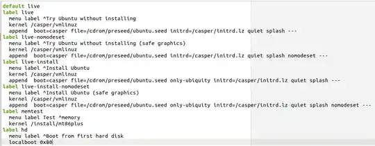

- Unmodified isolinux/txt.cfg looks like the following and I erased all contents inside:

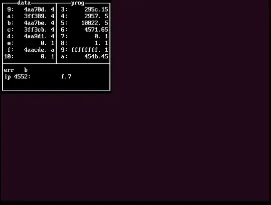

- Unfortunately, this was my output:
I'm super confused as to what files to modify. I'm not able to understand when the isolinux is used and when grub.cfg is used. Do I have to modify both the same way ? Can someone help me out on this please ?
