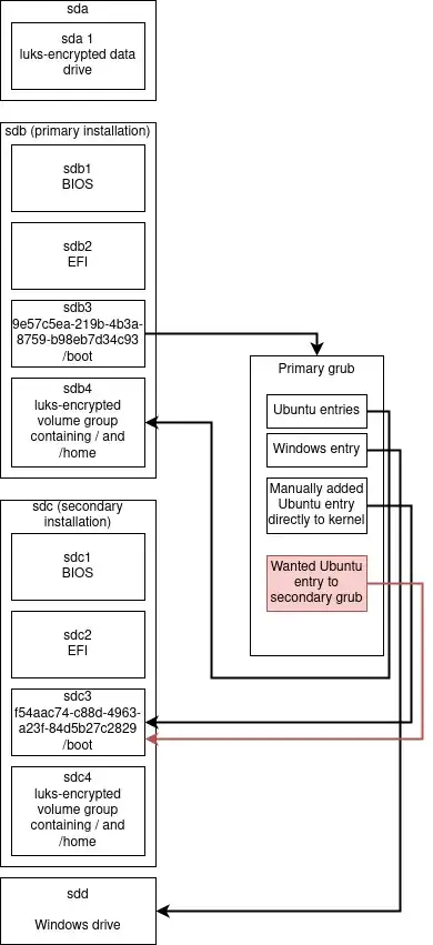

Of course this will fail as soon as the kernel of second installation is updated as it points to a specific kernel. So I want to load the grub of the second installation from the first installation. I created the following image to illustrated the situation: desired grub setup
