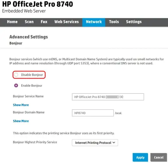

Therefore, a better approach may be to turn off Bonjour on your printer. Bonjour can be easily disabled for individual printers without uninstalling software on every computer on your local network.
Note that turning off Bonjour does not prevent you from printing to and communicating with your printer, as long as you have explicitly set it up in Ubuntu.
Your printer should have a setting to turn Bonjour on and off. Here is an example from an HP printer...
