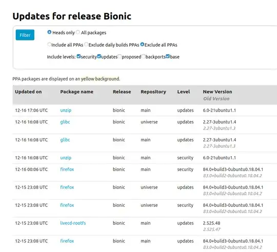

Nothing is wrong with your systems, at least that is causing this.
Updates have resumed as of 1/4/21. If you do not receive any updates in the next day or so, please report back.
There haven't been any updates since then to the 18.04 repositories. I suspect they're taking the last two weeks of the year off. I got a google-chrome-unstable update on the 18th, but that is from a PPA.
The "stuff downloaded" is the index files that your systems use to determine if there have been updates or not.
Source: Ubuntu Updates
