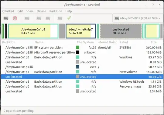

I have 68 GB of unallocated space on my disc and want to merge it with my Ubuntu partition (/dev/nvme0n1p7). I have dual boot Ubuntu 20.04/Windows 10. In Gparted, it looks like this:
gparted
However, the option for resizing the partition is greyed out in Gparted. I have read a few times that I had to boot a "live version" of Ubuntu and open Gparted there. But I don't have a CD or USB stick etc., which have been recommended all the time. I also don't want to delete partitions or things like that.

It is possible to use GParted without a usb stick or cd. I have this working on several systems. What you do is place the GParted iso in your esp/EFI partition and add a custom entry to grub. You need enough free space for the iso which is about 400MB from my vague memory.
The details are here:
https://gparted.org/livehd.php#live-hd-grub
I followed the instructions in the NOTE part of the grub 2.x section.

You need to move 1p4 so the two partitions that you want to merge are one after the other. Then you will be able to resize 1p7 to expand it and take all the unallocated space.
