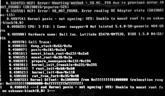

Before the last shutdown of Ubuntu 20.04 my storage space of disk was very low, then after starting my laptop this error occurs.
Error: no partition found
Cannot read or write outside partition
When I enter into the command line by pressing the c key grub> loads, but on giving commands like ls, cd, sudo, etc. it says error: can't find command...
After pressing the power button, the first thing that comes to the screen is error: no such partition, four times the same sentence is repeated, and at the end Press any key to continue On pressing any key, some options appear.
  • Ubuntu
  • Advanced options for Ubuntu
  • Memory test
but all results to reload the boot but no results. On restarting sometimes this kernel panic screen also appears.
Another time it goes until ubuntu logo appears after which login field to appear but after logo, immediately black screen appears saying
/dev/sda4: clean, 1500298/7749632 files, 29454730/30995712 blocks
And nothing happens, until I press power button and it shutdowns
The error was due to low storage, after access the machine via live Ubuntu usb freed up some storage and now its working.
