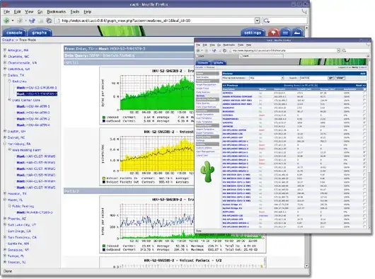

Cacti
Cacti is a complete network graphing solution designed to harness the power of RRDTool's data storage and graphing functionality. Cacti provides a fast poller, advanced graph templating, multiple data acquisition methods, and user management features out of the box. All of this is wrapped in an intuitive, easy to use interface that makes sense for LAN-sized installations up to complex networks with hundreds of devices.
Installation:
sudo apt-get install cacti
Click this to read about Cacti features

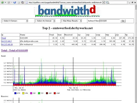

Bandwidthd
BandwidthD tracks usage of TCP/IP network subnets and builds html files with graphs to display utilization. Charts are built by individual IPs, and by default display utilization over 2 day, 8 day, 40 day, and 400 day periods. Furthermore, each ip address's utilization can be logged out at intervals of 3.3 minutes, 10 minutes, 1 hour or 12 hours in cdf format, or to a backend database server. HTTP, TCP, UDP, ICMP, VPN, and P2P traffic are color coded.
Download from here.
Read more about here

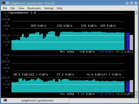

speedometer
If you need a live monitoring of the inbound and outbound traffic rate across a network interface you can try speedometer. I found this command-line based tool very user-friendly.
Install speedometer:
sudo apt-get install speedometer
Use the -rx and -tx options to display bytes received and transmitted on network interface. For example, if your network interface card name is eth0 use the following command:
speedometer -rx eth0 -tx eth0
A live graph like the one shown blow will be displayed in the terminal window. By default, the graph is updated every second. You can change update intervals if you wish.
For more information read the man pages using man speedometer after installing.
