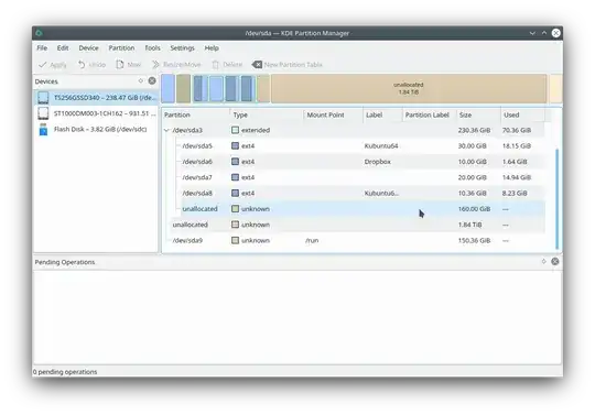

Using the KDE Partition Manager on the 20.04 Live trial, I selected to shrink that old Kubuntu partition (which hasn't been used in years, may not even be bootable), move the /home into the freed space, and expand /home to fill the newly freed space at the end of the drive. Everything went smoothly for 45+ minutes while the partition geometry was set, the partition moved, and the geometry reset for the larger space -- but during "expand file system" I was informed that "errors occurred -- aborting". Now, my entire 150 GB /home partition is inaccessible. KDE Partition Manager now reports 160 GiB "unallocated" where my /home should be, 1.84 TiB unallocated space following it (on a 256 GB SSD), and 150.36 GiB (the size of my old /home) with mount point /run and outside the extended partition that it should be in.

Screenshot of KDE Partition Manager

The /home should be /dev/sda9 -- I don't recall immediately whether it was labelled as "Home" or not.
Here's the exported partition table -- I'm afraid to edit this without coaching, but apparently KDE Partition manager can export and import it, so it's possible. As noted, the /home should have been in /sda9.
##|v1|## partition table of /dev/sda
# on Friday, 25 December 2020 22:16:46 UTC
type: "msdos"
align: "sector"
number start end type roles label flags
1;63;208844;ext4;primary;"Boot";"boot" 2;208845;16996769;linuxswap;primary;"";"" 3;16996831;500103449;extended;extended;"";"" 5;16996833;79907309;ext4;logical;"Kubuntu64";"" 6;79907373;100888199;ext4;logical;"Dropbox";"" 7;100888263;142833914;ext4;logical;"";"" 8;142833978;164562943;ext4;logical;"Kubuntu64_16.04";"" 9;4459532288;4774856044;unknown;primary;"";""

1;63;208844;ext4;primary;"Boot";"boot" 2;208845;16996769;linuxswap;primary;"";"" 3;16996831;500103449;extended;extended;"";"" 5;16996833;79907309;ext4;logical;"Kubuntu64";"" 6;79907373;100888199;ext4;logical;"Dropbox";"" 7;100888263;142833914;ext4;logical;"";"" 8;142833978;164562943;ext4;logical;"Kubuntu64_16.04";"" 9;164562944;500321424;ext4;logical;"/home";""
However, while other devices have an option to import a partition table within KDE Partition Manager, that option is greyed out for this SSD ("Export partition table" is available, but not "Import partition table").

You can try partition recovery tools to reset partition. Testdisk is often used and parted rescue. Testdisk finds all the old versions of the partitions you have, so if many changes, can be difficult to sort out correct set of or partition to restore. You only have one partition so should be a bit easier. Some also use parted rescue where you have to give it approximate start & end of a partition.
http://www.cgsecurity.org/wiki/TestDisk
https://www.cgsecurity.org/wiki/TestDisk_Step_By_Step
https://www.gnu.org/software/parted/manual/html_node/rescue.html
Often after a repair you need file system checks. if ext4 format, you run fsck or e2fsck. Example commands for e2fsck:
