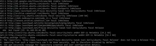

When I type the command: sudo apt-get update, I got the error below:
Err:12 http://ppa.launchpad.net/freyja-dev/unity-tweak-tool-daily/ubuntu focal Release
  404  Not Found [IP: 91.189.95.85 80]
E: The repository 'http://ppa.launchpad.net/freyja-dev/unity-tweak-tool-daily/ubuntu focal Release' does not have a Release file.
Here is a full output of my command:
command output
I would like to get rid of this error and install Unity Tweak Tool in the easiest way possible.
Artur Meinild
  • 31,035
Unity tweak tool is already in the official ubuntu repository, look:
$ apt search unity tweak tool
unity-tweak-tool/focal,focal 0.0.7+-0ubuntu6 all configuration tool for the Unity desktop environment
Then you don't need anymore to have their repository installed. You can remove it from the /etc/apt/sources.list.d/ directory or its specific line from /etc/sources.list file. If you don't know how to remove the file or edit the file just ask. After that simply update again your installation with
# apt update
or
$ sudo apt update
