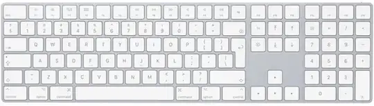

The "International Keyboard" layout from the apple magic keyboard seems to be missing, there is an international layout for UK, but the plain international layout is not there:
English (International, Macintosh) <- missing layout
magic keyboard (international) * This is the layout that is missing

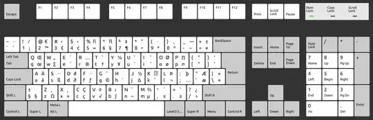

as a reference here are the other macintosh keyboard layouts, whereas the closes keyboard layout is the English (UK, Macintosh) but the shift + 3 combination is incorrect.
  • Shift + 3: should be # but instead is £

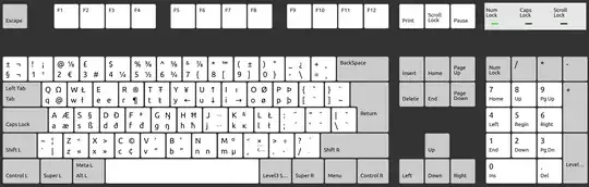

English (Macintosh)
English (Macintosh)
  • The keys left of Z should be backquote key and ~
  • The keys left of 1 should be § and ±

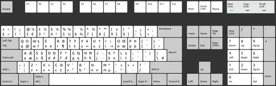

English (UK,Intl., Macintosh)
  • Multiple shift + number keys are incorrect
  • Multiple super + number keys are incorrect
